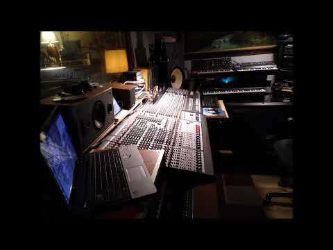

So, this is a test run of a song that was mixed to 3 different rates.
48/24
192/24
192/32
Can you give a listen and choose one that sounds like it’ll be the one you would go with?
Just an experiment. No pressure!
Lol. Thanks.
will listen later but it would be impossible to tell in a youtube video that is already re-sampled to 32 bit aac, and the avc codec. So essentially I am hearing everything in 32 bit depth, 384 k bit rate enveloped in assuming an mp4 wrapper lol
do you have audio files for these somewhere other than youtube?
but either way my guess is that the middle one is what I prefer ( around 6:00) over the other 2 for some reason, but not a fan of either of the 3 mixes. However, I also dont know if these are live recordings of some live performance.
Thanks for your participation @FluteCafe !
The only difference is that these were exported to different rates, and yes the Youtube medium is part of my experiment process.
Tangent Alert: There’s lots of talk these days about mixing on headphones for a myriad of reasons that are outside the recording studio or mastering lab environment. Yet, they still come into play when proponents say they are mixing for people who listen mostly on ear devices.
So…are there also subtle differences in export rates when comparing them over the YouTube codices?
Your response of choosing the middle one is notated and your gift card will arrive soon! Thanks.
If you are trying to avoid aliasing artifacts, the common practice is to oversample before you run it through plugins. Then downsample during rendering.
Depending on what video codec you used to make your youtube video, youtube will upsample or downsample everything to 48k Opus format regardless of what format was uploaded (such is the case with your video. Your video is playing Opus audio format).
Which means if you resampled it more than twice, chances of artifacts increase everytime to a point where it will be audible. Best practice to upload to youtube is to sample everything to 48k and nothing higher or lower. Then YT leaves your mixes alone and merely turns the volume down if it is too loud.
