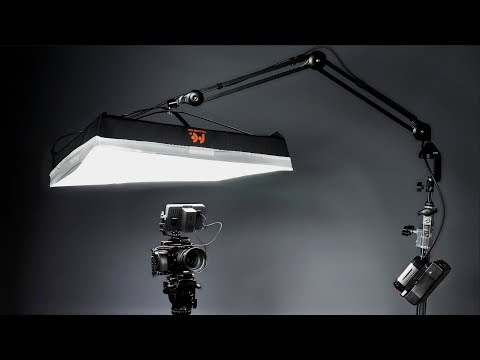

This looks like a bit of a project but might get the mic overhead, retractable, but not on the ceiling…
Maybe combined with a ceiling mount of this type:
The biggest problem I’ve seen with all of these scissor arm things is that the connection to the mount is gravity held, meaning it’s just a pin in a slot, so they can’t be mounted upside down without having to rig up something to hold it in place without falling.
I saw that thing too. My biggest fear with it is I’m worried about having such a long rigid pole being secured by such a small base. It seems like a leverage nightmare, but maybe it’s not as bad as I’m imagining.
